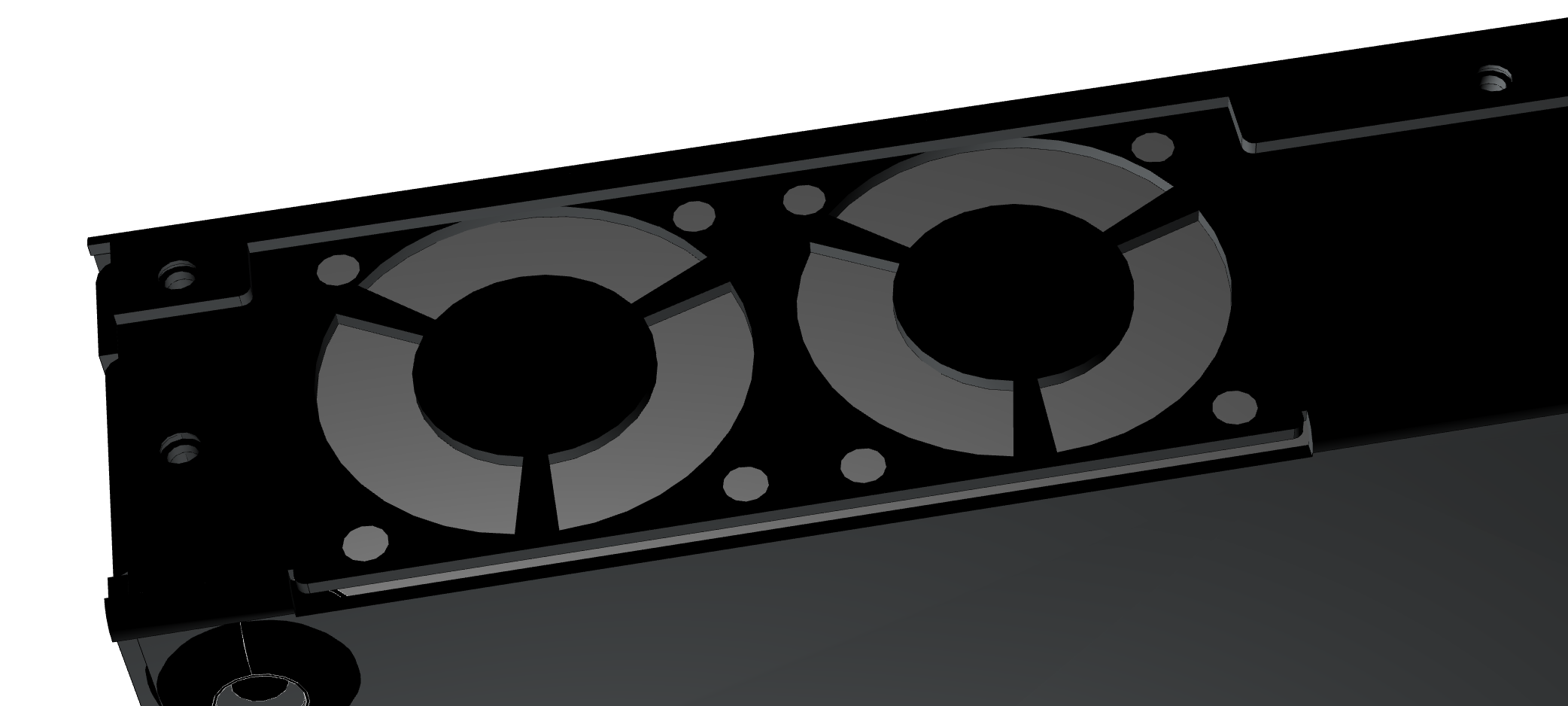

OK thanks for the explanation.
Now i know why it is a fixed template... this enclosure had fans cutout that were too close to the top and bottom, so we had to add cuts to the top/bottom edges in order to fit them (see picture).. that must be why...
Only surface finish can be changed. Metal is fixed to 0.051 ALU as per our original design.
We also had bent flanged at the front so the cover bents slides into front pannel bents... but with the template, we lost them..
