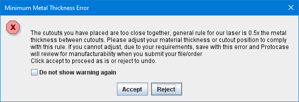

Just for info, in PD version 5.6.6 the default Mini USB library is still not fixed, or at least not completely fixed: when placing the Mini USB cutout, a warning still occurs (see snapshot), except that after ignoring the warning the resulting cutout seems to be ok in the final drawing.

Hello Cristi,
This cutout is now on the online library so maybe something got undone when that happened.
Updated the online version of cutout so all you need to do is go to your Library Manager find the cutout and click the Download button.
Thanks for the let me know.
