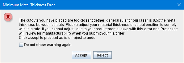

Just for info, in PD version 5.6.6 the default Mini USB library is still not fixed, or at least not completely fixed: when placing the Mini USB cutout, a warning still occurs (see snapshot), except that after ignoring the warning the resulting cutout seems to be ok in the final drawing.
I still have the patched library you sent to me at the time of my original posting here and it still works fine, so for me this is not a true issue – in a certain sense, on the contrary: between the two libraries (i.e. the default and the patched) there is a difference regarding the cutout origin (the red dot), in that on the default library the cutout origin is in the geometrical middle of the cutout, while on the patched library the cutout origin is on the "left" side at the junction between the larger and the smaller ovals; for a new drawing, the centre origin is preferred, but for one of my old drawing I just enter/keep the old offset coordinates and so the cutout goes to the exact same place as before.
