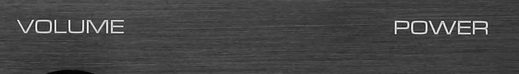

Thank you for that and I see that the grained finish is what I need,
but (and this is the last question before I finish up with my designs - I hope)
how will the colour of the grained finish be black? Do you offer black anodization or some other way to paint it black and keep the brushed grooves intact?
I am asking all this to avoid remaking the whole design and because I want exactly this look, as follows, on the front face of my htpc and an amp face I am making.
Thank you again so very much for your assistance.

the color of the grained finish will be that of bare cold rolled steel (or aluminum if you use that metal). You can see examples of the bare metal finish on the page I linked to you. They don't look quite as dark as your picture. If you have more questions feel free to contact me again!
Colin
