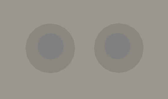

What is the second outside circle that gets added with a countersink? Is it a keep out? It seems too large for a keep out. Also, it doesn't seem to cause a design error if I have the outside circles of two countersinks overlap.
What is the minimum distance required between two centers of #4 82 degree countersink holes? Thanks.

The outer circle is the outer diameter of the end of the screw you have chosen to countersink. You should try to keep the countersink's outer circle clear from any intercepting cutouts, other fasteners, etc.
It doesn't pop up a warning though? Can you send me your debug.0.log from your ProtocaseDesigner directory? If you are on windows this is probably in your Documents folder.

I don't think that the circles are correct, then. I assume by "end" you mean "head" diameter. I measured the diameter of the outer circle in the tool for a #6 countersink and it is ~.557 in. It should be more like .279in max based on https://www.guden.com/StaticHtml/Countersink/index.html.
I placed two countersinks so that their outer circles intersect and no error was produced when I did a design check. Debug log below: Startup, load test file with countersinks, perform design check, exit.
Face Editor
Face Editor
5-16-2014 2-47-40 PM.png (2.06 KiB) Viewed 22654 times
Countersinks on Panel
5-16-2014 2-48-40 PM.png (4.05 KiB) Viewed 22656 times

- Doug

Thanks for sending me this Doug, I will take a look into it. I will let you know as soon as I have this sorted.
Could I get your email so that I can let you know?
Also, could you attach the file as well so that I can load it up in my protocase designer and take a look?

Hey Doug,
Sorry it took me so long to get back to you. This forum's updates don't seem to be working.
Thank you so much for your help, I have created an exclusion zone(keep-out) on countersinks and straightened things up so now the outer ring will be the width of the outer diameter(I was using the wrong formula) of the countersink and it will have a bright red shading so that you can clearer see how close you can put it to other cutouts and such.
Thanks again for the test file.
