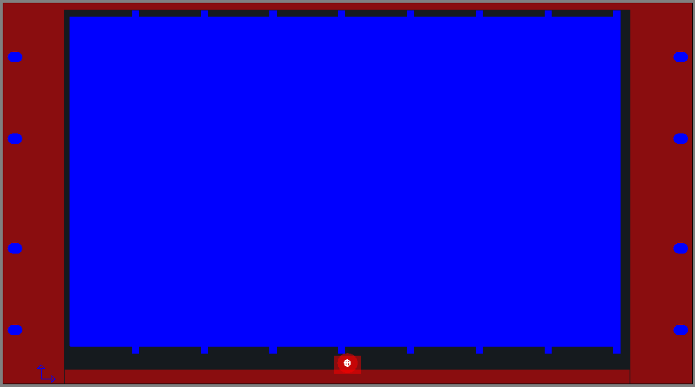

I'm using Protocase Designer 4.3.2 (4.4 won't work on my system, osX 10.9), and I have problems designing case and understanding template...
I'm using 19" rackmount template, 6U height, 550mm depth, and I need front face divided in 8 segments (pic.
front_face_outside
front_face_outside
Screen Shot 2014-01-21 at 20.39.40.png (17.14 KiB) Viewed 19764 times
What is use of this hole in the middle of front face?

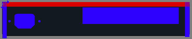

Also, rear face is smaller than front face? (pic.
rear panel outside
rear panel outside
Screen Shot 2014-01-21 at 20.42.50.png (13.83 KiB) Viewed 19760 times
). I need same cutout on front and back face, with cuts 47mm apart that protrude 5mm, and total height of at least 235mm (without that 5mm cuts).

There is a stud from the front face that goes through a flange on the base (you can see it if you remove the cover with the Show/ Hide Parts menu item). If it really causes you trouble we can put two studs on the outer parts of that flange instead.
The rear is smaller than the front - there is room for rails to be mounted around the enclosure. In the new version of designer you have the option of making a full height rackmount if you do not wish to use rails. I will test the Mac version of the new designer within the week.

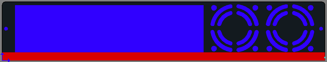

Now, i have new question. In that 6U case goes 8 vertical U-shaped plates that hold nodes.
Front plate is almost full 6U height (minus thickness of case plating) with two mounting holes, big cutout and two fans cutout. I need that big cutout to go from bottom plate (red zone in following picture), or max 2mm above it. Can that be done?
front plate.png (16.22 KiB) Viewed 19729 times
Also, rear plate should be lower for 12mm (6mm from bottom and 6mm from top) compared to front plate. When I put cutout to the edge, it still shows thin line?
back plate 1.png (9.35 KiB) Viewed 19725 times
back plate 2.png (24.88 KiB) Viewed 19722 times

So you are asking if cutouts can go from the very bottom to the very top? On the front I think this would take a special design from our tech team because of the mounting. In the rear, it depends on how wide the cutout is. The exclusion zones in the rear (Red Area) are the distance from a bend that cutouts must be to prevent distortion. However, if the cutout goes all the way through the bend it is not an issue. However, if the cutout was too wide, there would not be mounting strength left for mounting the case together. I think it would be best if you either called or emailed our sales department and they can get you in touch with someone from our tech team who can help you out.
