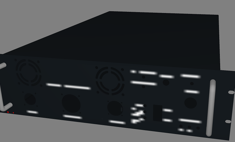

Every time I open a .pda file in protocase designer 4.2.13, all silkscreens are blurred. The only way to fix this is to open each face that contains a silkscreen, manually change one silkscreen, then save. Even after saving the project, closing it, then reopening, the same issue occurs. Any ideas on how to fix? Screenshot attached...

try putting the following line in your My Documents\ProtocaseDesigner\conf file with a text editor (wordpad for example)
silkscreenDisplayQuality: 6
Also, the quality you will get is the quality you see in the face editor, not the 3D view. The 3D view is limited by 3D rendering performance issues.
