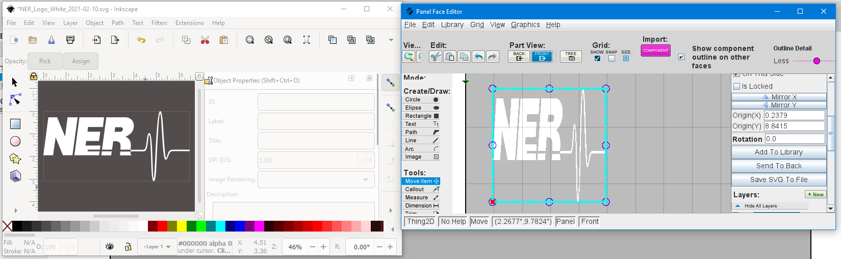

Opening the file with Inkscape on the left. PD on the right.
No changes made in either program on opening/importing.
The PD SVG import looks to be 'square'.

ah. Looks like it normalizes to 1:1 ... for some reason but that is wrong. Will get a bug fix in to keep the proper aspect ratio. 8-)
